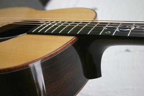

Here are some shots of my latest small jumbo, let me hear what you think!
Alaska sitka top
East Indian Rosewood back and sides
Mahogany neck
Curly koa binding
Ebony fingerboard and headstock overlay
Brazilian rosewood bridge
"Tor-tois" pick guard
Some numbers:
645 mm scale
405 mm lower bout
295 mm upper bout
500 mm body length
45 mm nut
The finish is nitro over epoxy pore fill. The neck is stained with colortone dark brown aniline dye, which brings it pretty close to the rosewood hue.
It sounds pretty good if I must say so myself! This is the third one I made with this shape (my 10th guitar total), and I'm keeping this one for myself.

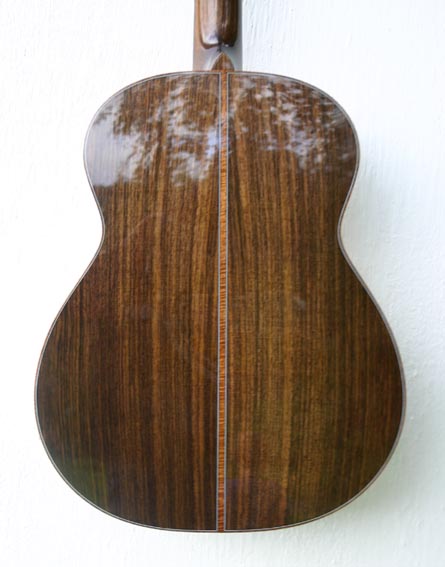

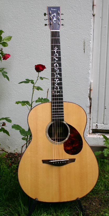

Here's the full frontal:
The back:

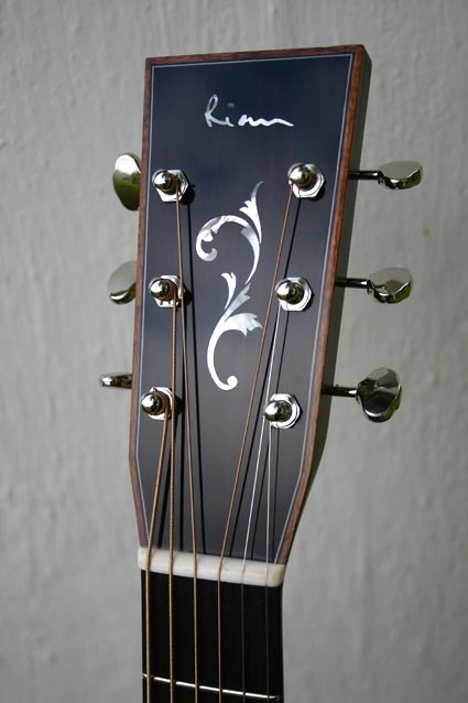

The headstock:

Wow Arnt, I like everything about that guitar. Very nice headstock treatment. Good job

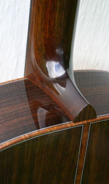

A couple of more shots.
Here's the heel:
And the body joint:

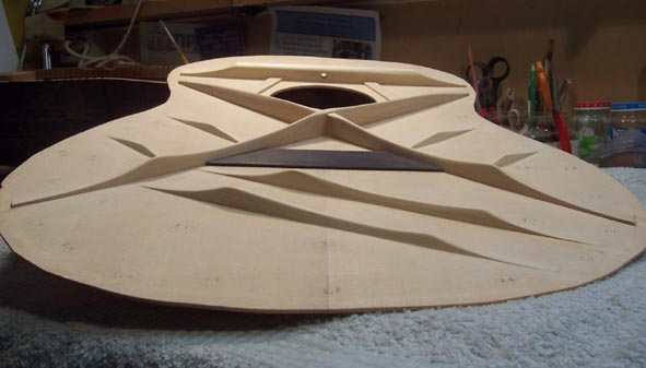

The bracing is pretty standard I guess, "forward shifted" and scalloped X-braces, African blackwood bridgeplate. The specks you see on the plate is where I write down the plate thickness on that spot. I graduate the plate thickness towards the lower bout's edges, and I write down the numbers for the record.
Braces:

Arnt! That is a VERY nice guitar! Thanks for sharing it with us!!
I love the headstock, and your name logo, so understated!
Nice work!

Thanks again guys. The headstock shape is heavily inspired by Martin, so I don't feel I can take too much credit for it. The inlays and binding are just my take on an old classic, and the script on the logo is my own handwriting, cut out of pearl. Anyways, glad you all seem to like it!
